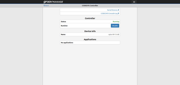

I’m running into a frustrating issue with CODESYS on a Groov EPIC unit. Whenever the device experiences a low battery condition or is booted up with no battery inserted, followed by a power cycle (turning the main power off and back on), the CODESYS runtime fails to boot, and Groov Manage shows “No application”.
Initially, I suspected this was related to persistent variables. My theory was that a missing or weak battery fails to retain persistent data, causing a checksum mismatch during startup, which might force CODESYS to refuse to start.
To test this, I uploaded a fresh, completely blank CODESYS program (with zero persistent variables) and power-cycled the unit. Unfortunately, the issue persisted—upon rebooting, Groov Manage still showed “No application,” and CODESYS wouldn’t boot, requiring me to manually re-download the project from the CODESYS IDE every time.

In your original post you said that codesys fails to boot, but the screenshot seems to contradict that and shows that codesys is running but that no applications are running. Is that the case?

  2. You are completely right that was my mistake in wording. CODESYS itself is running, but Groov Manage / the runtime shows “No application” loaded.
