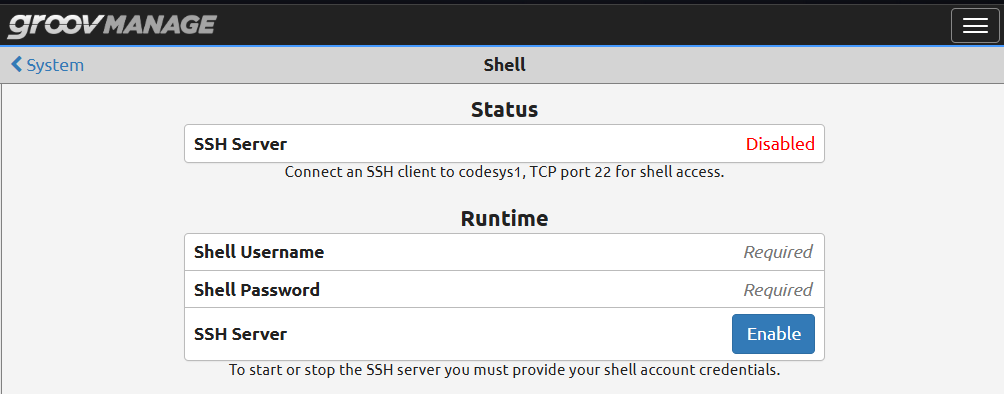

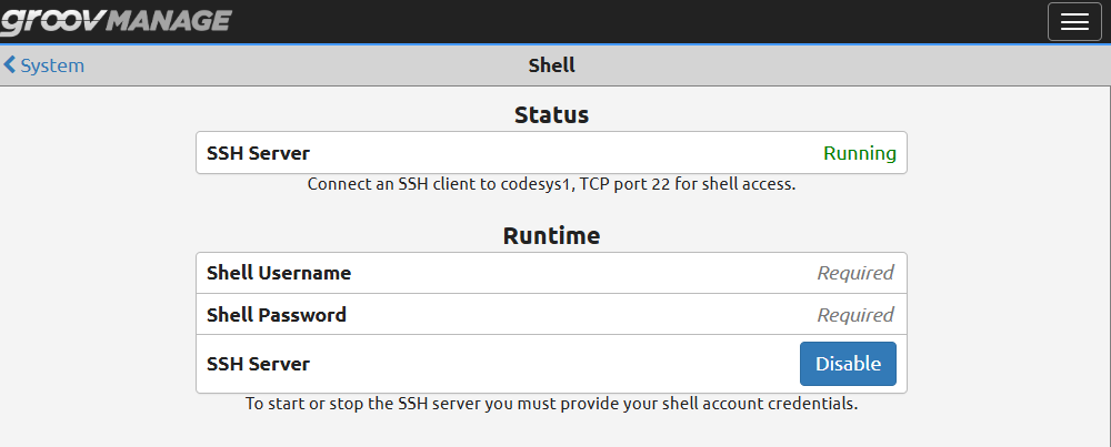

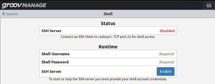

If you need to disable SSH access, you can do so directly in groov Manage:
This stops the service and disables the firewall rule, removing all access to SSH.

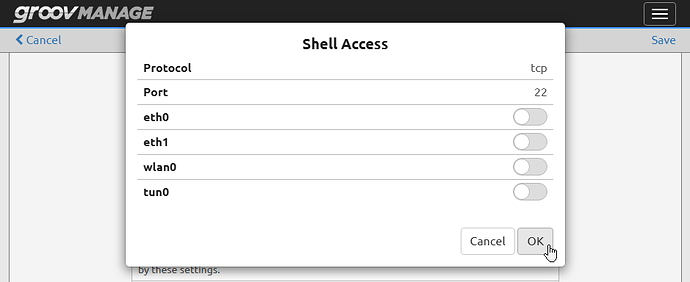

Another option for anyone checking out this thread: if you have groov Manage admin access but do not have the SSH account username and password, you can also “disable” SSH by just turning off firewall access for the SSH port 22.
(It’s essentially the same as turning off through the shell menu, just be aware that it can be toggled back on just as easily with Manage admin account access.)
