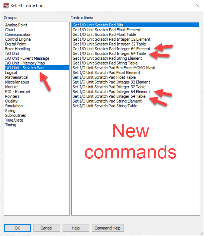

Almost there with the screenshots… For those of you that love to throw around 64 bits of bits (heh, see what I did there?) we have some new commands for you…
