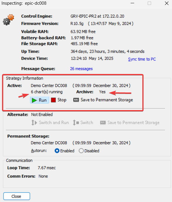

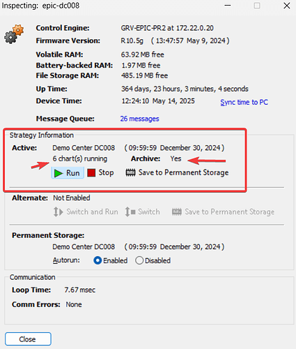

Just keep in mind that the previous person had to have checked the ‘save and upload to the controller’ option, or there will be no zip in the controller memory.
This is the section you are looking at in PAC Terminal.
The number of running charts will depend on your strategy.
Clearly, you should not be clicking buttons in this dialog, just using it to see if there is a zip archive of the strategy.

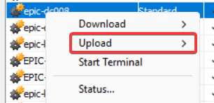

Right click on the controller name and select strategy archive and save it on your PC.
Unzip it and get to work < grin> :
EDIT: Keep in mind that these commands are in reference to the controller, so you are going to upload from the controller, to your PC.
