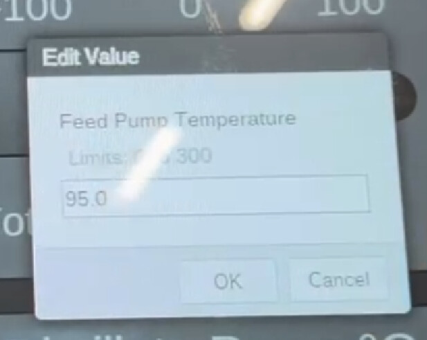

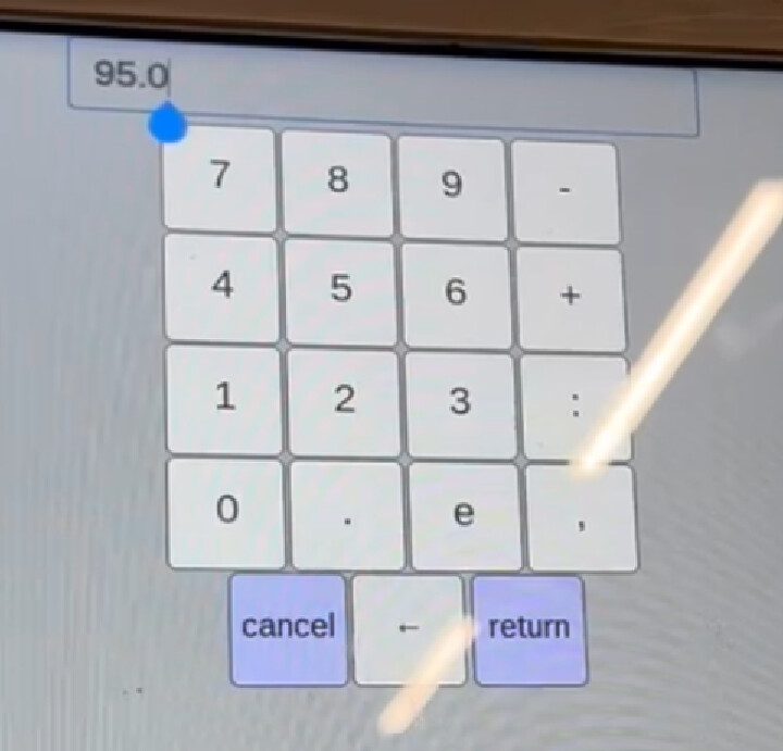

This is what they see when they tap a text box gadget:
A full screen numeric entry screen with keyboard displays with the value to edit at the top. (Note that they do not know if they tapped the correct gadget as this screen doesn’t show the pre or post prompt, it only has the numeric text box and the keyboard, so that is sometimes a problem for them.)
They have to use the backspace on the on-screen keyboard to remove the existing value, enter the new value and then press return.
Then they need to press OK on the small Edit Value window (which will show the pre and post prompt - so they verify after they enter the value and cancel if they have the incorrect tag).
We are scheduled to update the firmware today so I will see if any of this changes with the latest.
Edit: updated to 3.6.0 firmware and the behavior is the same.
