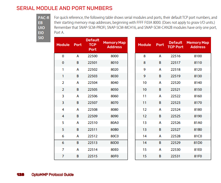

You can communicate with them via Ethernet and the module position on the rack port number.
Not sure if that’s an option for you, but just use the controller/brain IP address and the corresponding port number.
Because its a serial module, there is no fire-and-forget (take x steps at y frequency), so that is done in the controller in the firmware. Im unsure how to tickle that part of the MMP address space.

Thanks Beno. I was able to successfully talk with it and give it frequency and direction.
