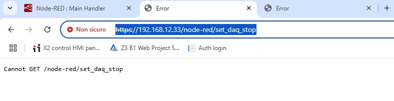

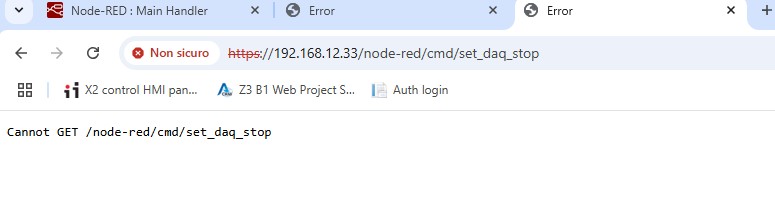

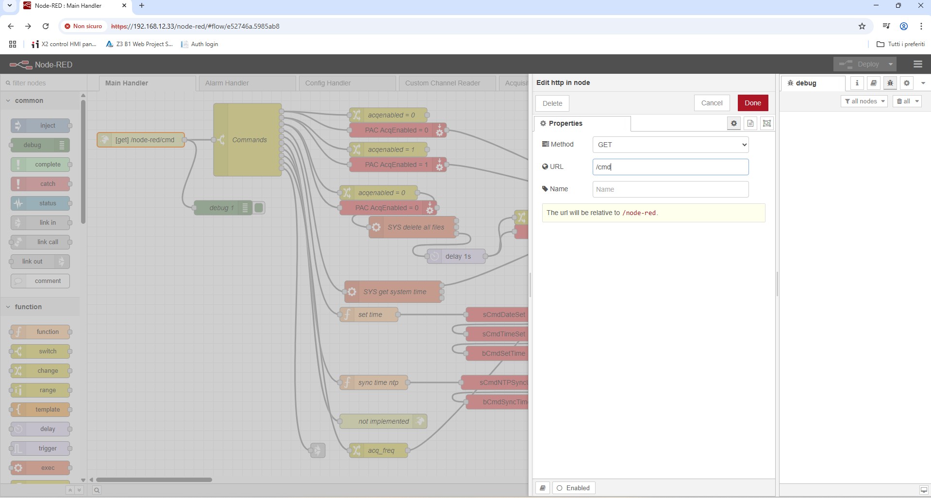

I have this Node-Red flow and I want to start it with URL. How can I do it? I try this ULR:

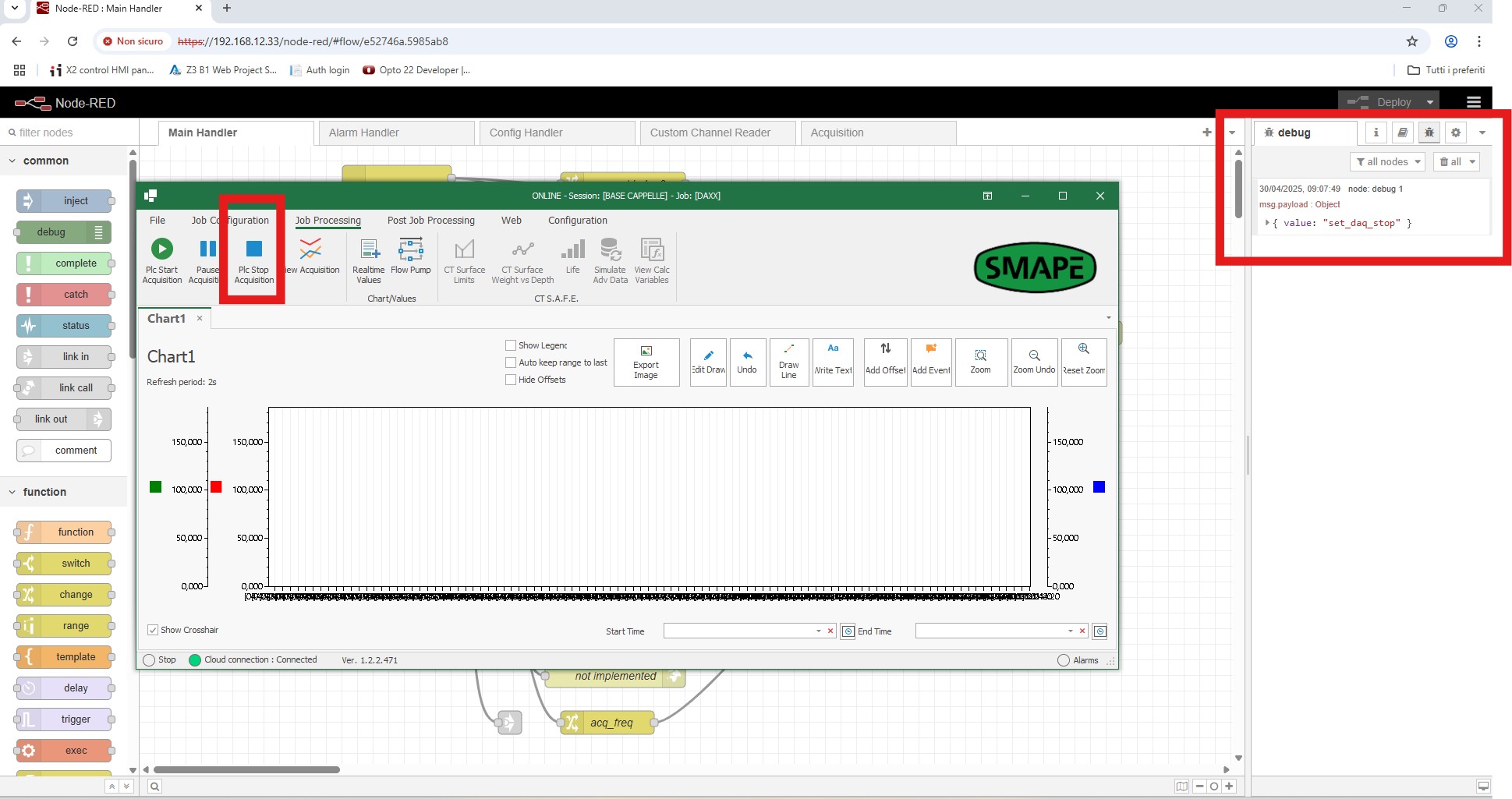

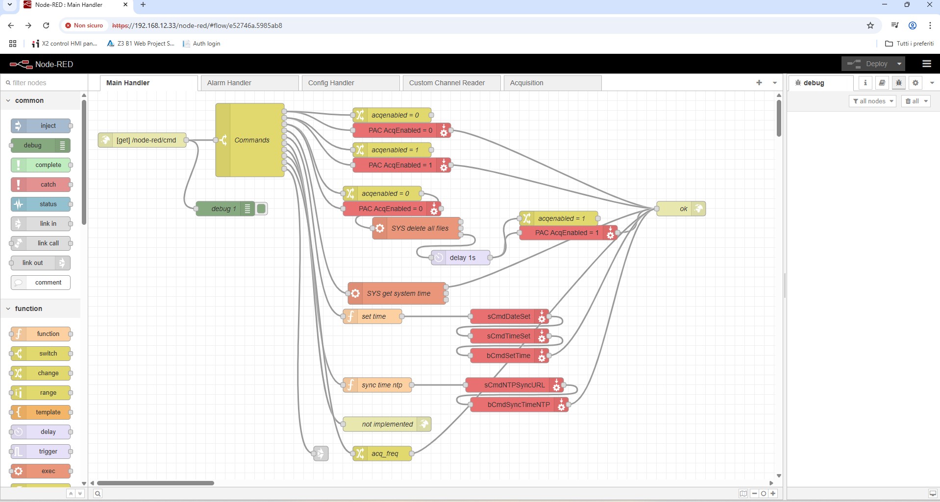

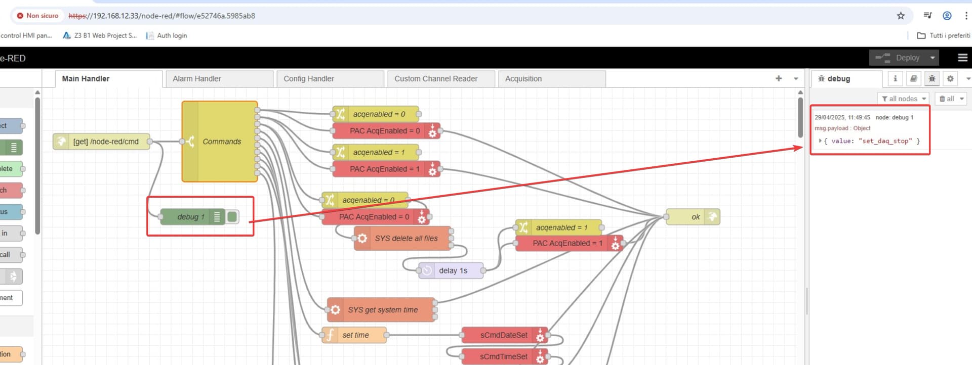

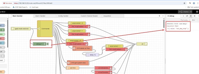

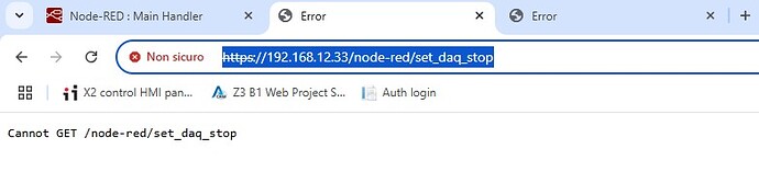

We have an acquisition software for logging our operation sensors and I want understad how it is working. For example if I push “PLC Stop Acquisition”, the software sends the command “set_daq_stop” to node-red but if I send “https://192.168.12.33/node-red/set_daq_stop” it doesn’t work. Probably into this software there is a routine for EPIC authentication, it is my supposition. I want to understand if we can interface with this node-red project with another software.
Thank You

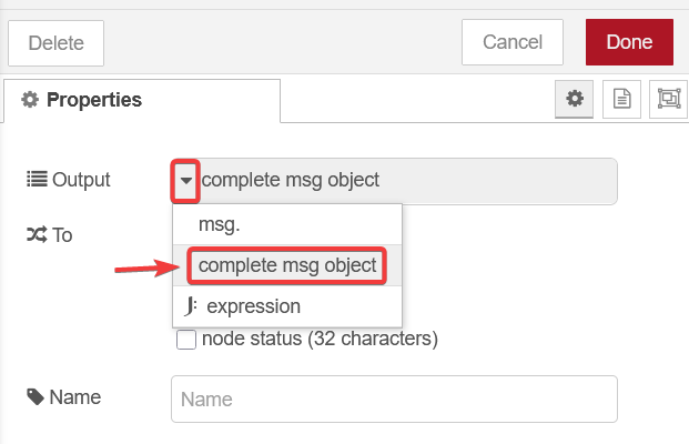

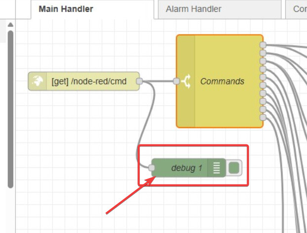

Change this debug here:
Looks like you have it set for msg.payload.
Change it like this:
That should better tell you whats going on.

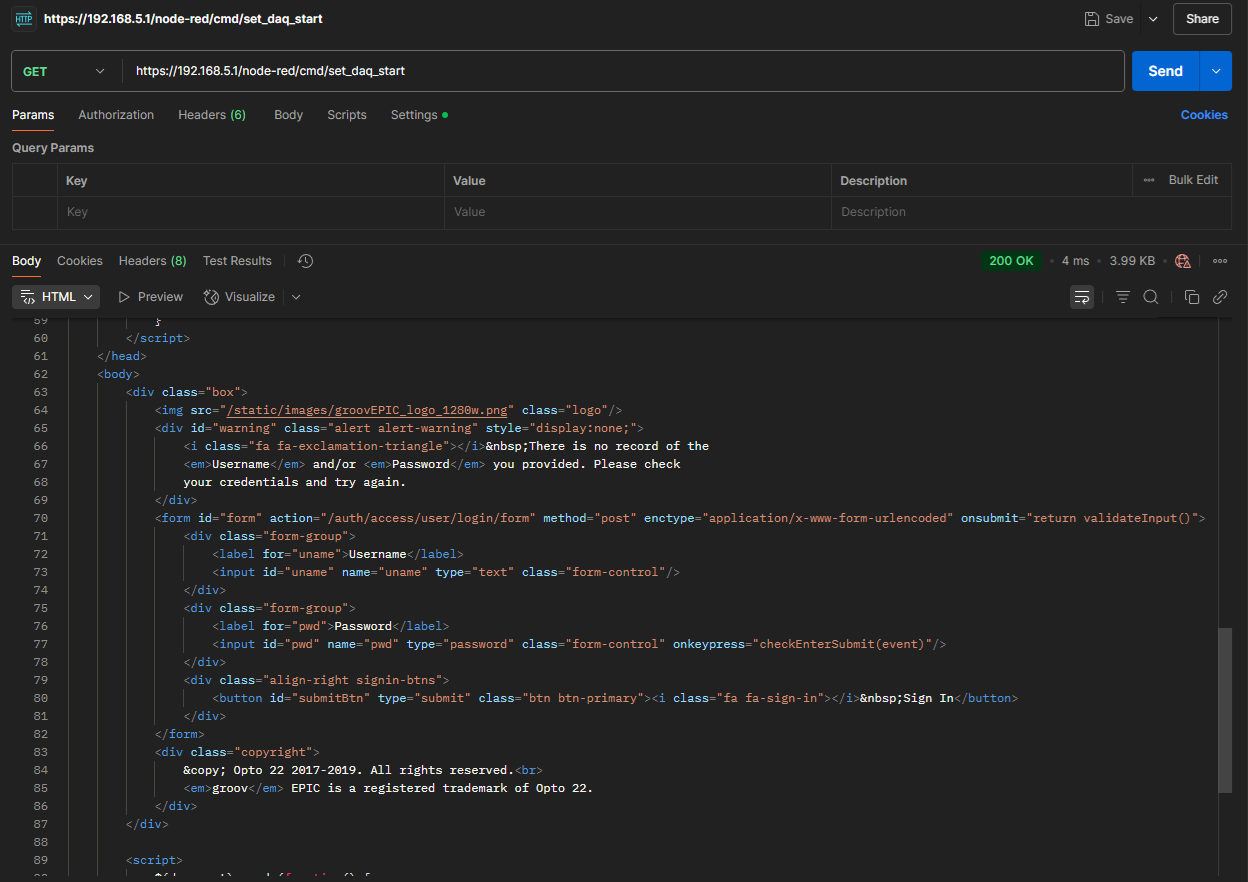

Hi Beno,

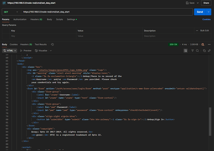

Whenever I try to make that API call from Postman, we get a 200 Response but the body is just HTML code that’s basically login prompt:
I’ve tried passing in Basic Auth Credentials but it makes no difference.
I added that debug output to the flow but it appears as it’s never even getting to it because the debug log never shows anything.

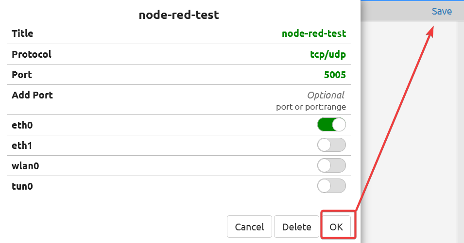

Next, you need to open the groov Manage firewall port for that port.
After you click Ok to add the rule, don’t forget to click ‘Save’.

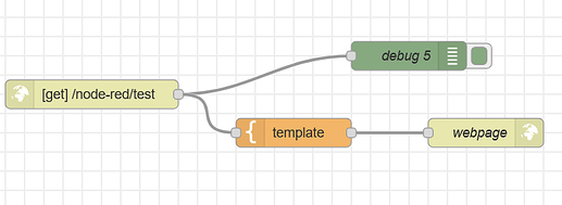

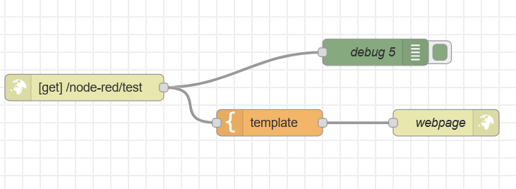

Here is my sample flow to get you started in testing this:
Import it: [{"id":"b0e58d561a178d2d","type":"node-red-contrib-http-custom-port","z":"1f5fad0db201833e","name":"","url":"/test","method":"get","upload":true,"swaggerDoc":"","port":"5005","x":310,"y":620,"wires":[["59e1ede2e6da9fb0","500bcf5db325f188"]]},{"id":"59e1ede2e6da9fb0","type":"debug","z":"1f5fad0db201833e","name":"debug 5","active":true,"tosidebar":true,"console":false,"tostatus":false,"complete":"true","targetType":"full","statusVal":"","statusType":"auto","x":640,"y":580,"wires":[]},{"id":"500bcf5db325f188","type":"template","z":"1f5fad0db201833e","name":"","field":"payload","fieldType":"msg","format":"html","syntax":"mustache","template":"<!DOCTYPE html>\n<html lang=\"en\">\n\n<head>\n <meta charset=\"UTF-8\">\n <meta name=\"viewport\" content=\"width=device-width, initial-scale=1.0\">\n <title>Devs page</title>\n</head>\n\n<body>\n <h1>Hello, OptoForums</h1>\n</body>\n\n</html>","output":"str","x":520,"y":660,"wires":[["355f5b64cf4f01db"]]},{"id":"355f5b64cf4f01db","type":"http response","z":"1f5fad0db201833e","name":"webpage","statusCode":"","headers":{},"x":720,"y":660,"wires":[]}]

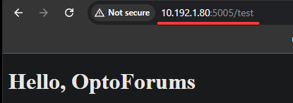

Now hit the IP address of your EPIC with port 5005 and the path of page you add, in my case it is /test.
Like this:
You should see the web page come back.
Lets know if that gets you up and running.
