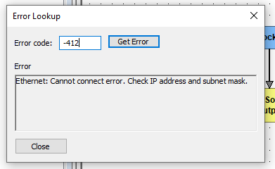

The -412 error code is:
Ethernet: Cannot connect error. Check IP address and subnet mask.
You may have a networking issue with the device you are trying to communicate with.

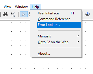

Also, for your reference, you can look up error codes directly in PAC Control.
Hey thanks for that information about the error lookup.
The issue is definitely a failure to connect to the device and not a networking issue, since the error is different depending on whether the device is plugged in or not.
