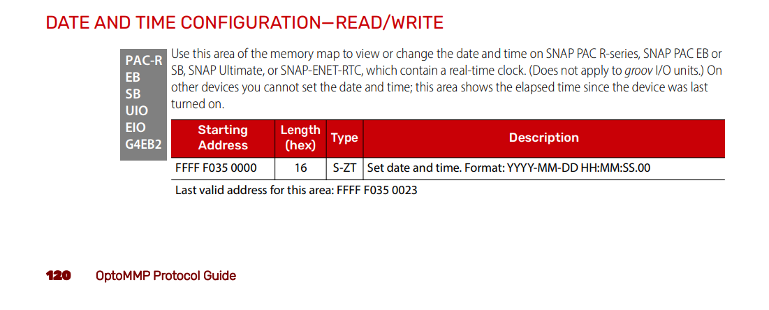

              Hello, you can find the Date and Time MMP addresses from Pac Manager under System and then convert the MMP addresses to Modbus using the Tools/Modbus Calculator in Pac Manager
              thank you, and for that would i could then write to those  addresses setting the time?
Would i to send everything individually in floats ie minutes seconds etc

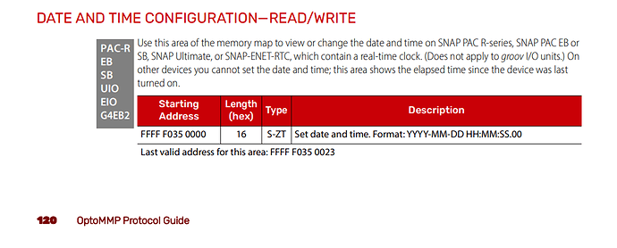

              Per the OptoMMP protocol guide date and time is in the format YY-MM-DD HH:MM:SS.00. The guide has more details about what each address holds and how to format data to write / how data is formatted when reading.
