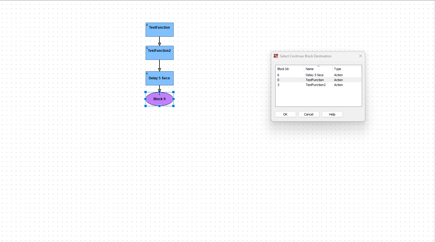

I suspect your charts do run and then end. I see the last block does not loop back to the top (or where you want it to loop to). Be sure and add a short time delay to the loop.

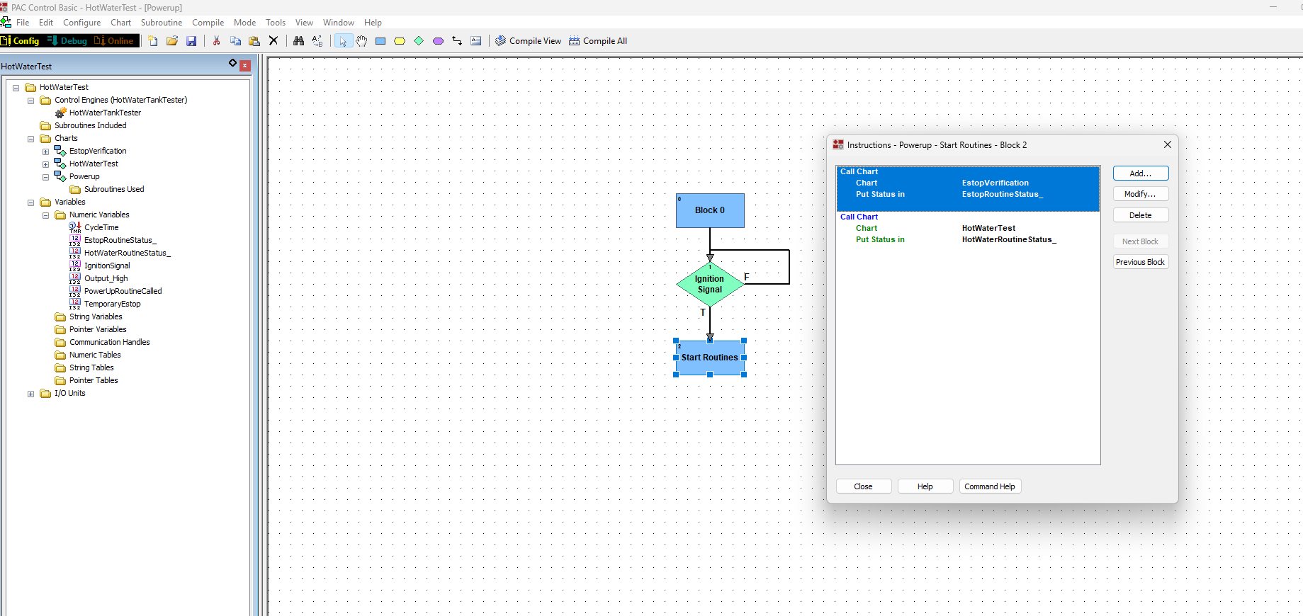

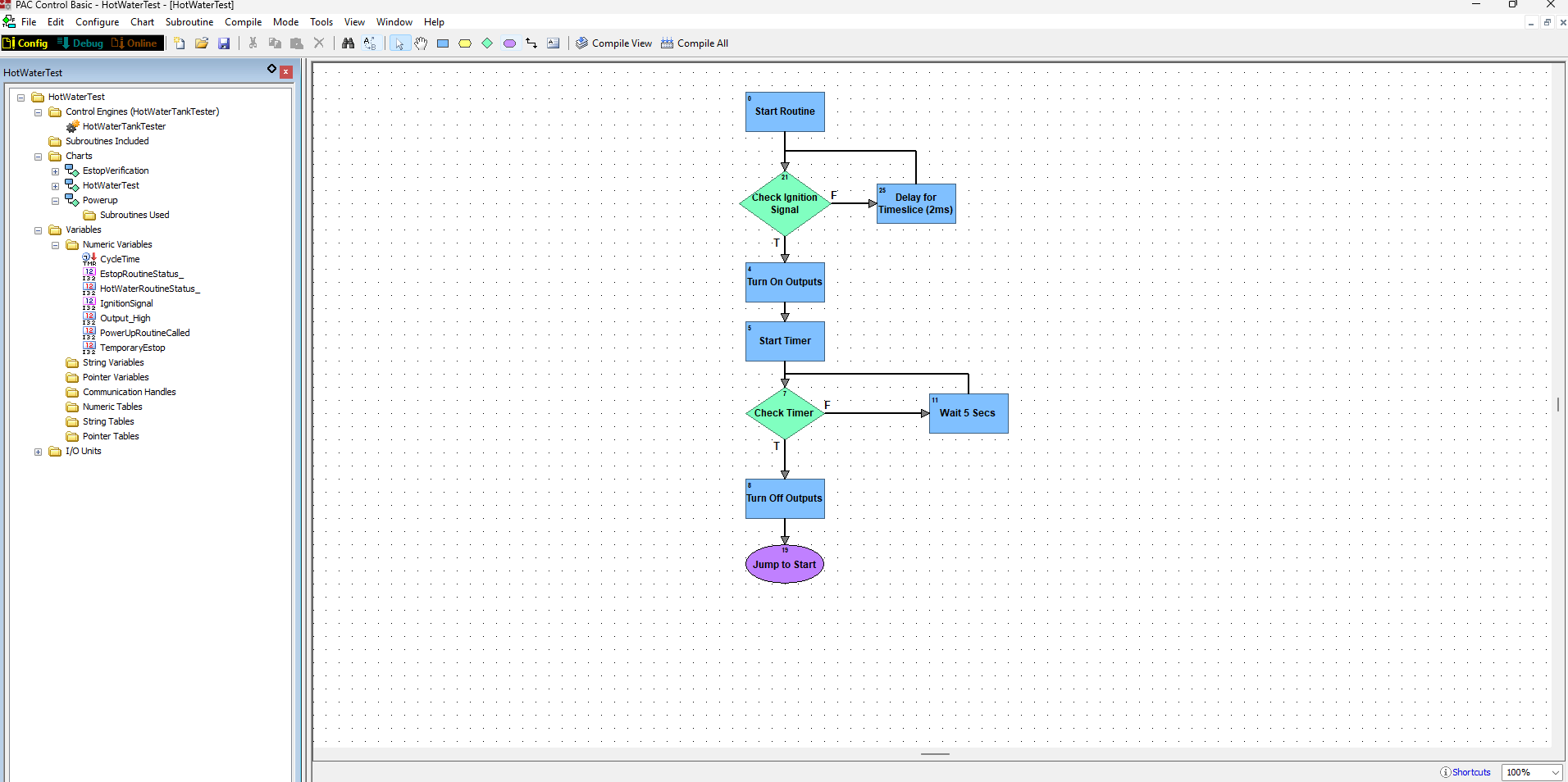

The Powerup chart is not supposed to run again. The hotwater routine is set to run again, and it works when I call it by itself. However, When I call both charts only one or the other runs. They both can run by themselves.
Hello, one thing I noticed is that you are using call chart and not start chart. Call chart will start another chart and immediately suspends the calling chart and automatically continues the calling chart when the called chart ends. Start chart will request that a stopped chart begin executing at Block 0

Thank you so much! I actually called Opto, and realized my mistake a few moments ago.
