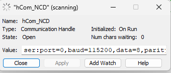

Here is the chart:
Here is the script for the read ncd/xbee:
After prasing the data I will close the communication :

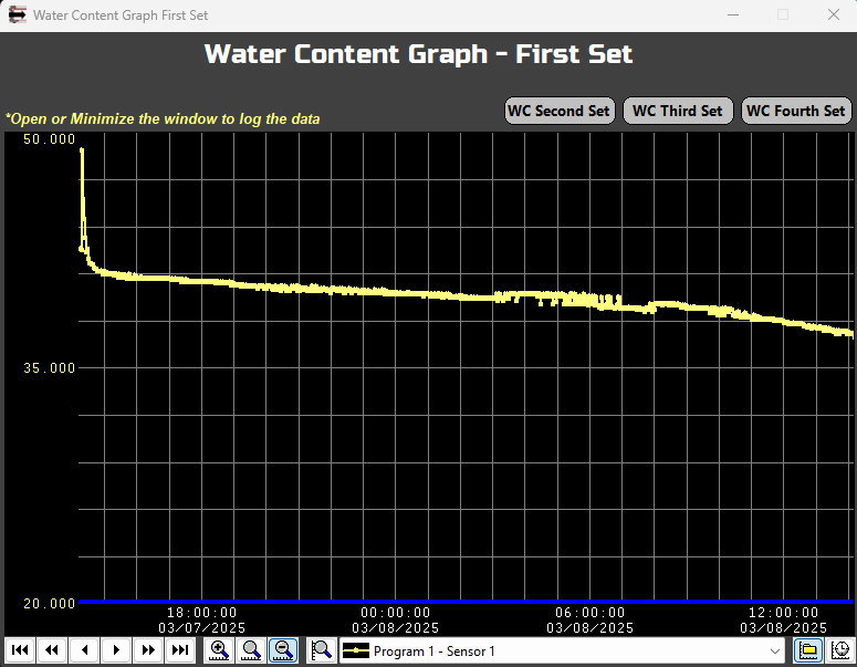

Here is the datapoints I am plotting in graph. The yellow marked is where the i couldn’t open the communication. After i restarted the controller it started to work. Whereas the red one, not sure what happened over there.
