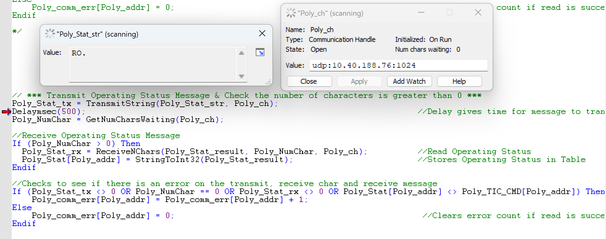

Any thoughts? I’m using Transmit String, Get Num Chars Waiting, then ReceiveString (only if NumChars > 0). Not getting any errors on Open Outgoing Communication or Transmit String – I’m just not getting any Characters in response (Num Chars is always == 0). Thanks! Let me know if you need more of my code.

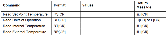

The communication chart is sending four commands via UDP (see table, all with a CR at the end, and responses get a CR on the end too. I have the EOM set to CR). On each of these transmit commands, Comm Handle should be picking up 2 - 6 characters (including the CR).
I’ve attached the Wireshark file as well as a text dump of the Data from Wireshark, showing the characters it’s seeing. There’s also a screenshot of my code in Debug, taken right after the TransmitString command, showing the lack of Num Chars Waiting on the Comm handle.
