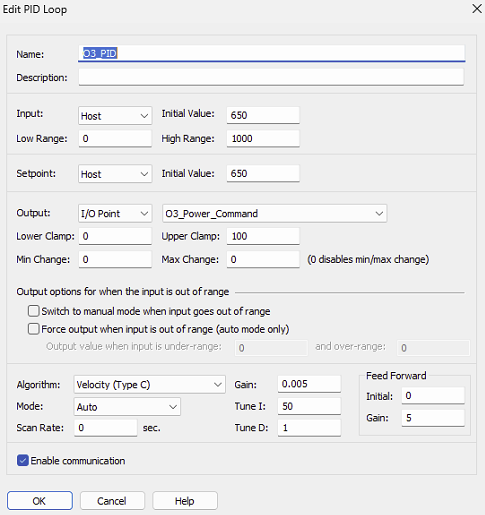

I’m troubleshooting an existing project at customer site that had a functional PID-loop which has stopped automatically updating it’s output.
It is a PAC-R1 controller, however, I noticed it does have an outdated firmware (10.4).
The latest changes to this system was a new PC which has the PAC Display that is linked with the controller. The new PC was updated to use the latest 10.6 PAC Project.
While online with the PAC Strategy, I can manually force a PID output value, and the value will reduce every scan time to quickly go to zero. The other PID parameters were not changed. I’m running the PID algorithm “Velocity (Type C)”.
I suspect it’s something simple, just strange how/why it has changed.

Hi Andre1. What I first noticed is that the Scan Rate is set to 0. The scan rate is very important because is sets how often the PID calculation will be performed. In general you take the lag time, how long it takes the process variable to react to a change in the output, and divide that time by 4.
Some references for this: TUNING A PID CONTROL LOOP TECHNICAL NOTE; an online tuner (scan rate explained in Step 7), and an in depth SNAP PAC PID Tutorial. The online tuner helps you create reasonable P, I, D, and scan rate values. Good luck.
Thanks Norma,
I noticed the zero scan rate after I sent it… however, the actual scan rate was set to 1.0 seconds during my live run during testing.
I guess my main concern with this was the controller’s firmware (10.4) not matching the PAC strategy software (10.6)… could this have caused the issue if there were some updates to the PID loop?
Thanks!
No, the controller’s firmware version does not need to match the software version. What you want to check is the SNAP PAC controller firmware Readme to see if it mentions a bug that resembles what you see; also review the PAC Project (for PAC Control) Readme. There’s mention of a PID bug in the controller firmware file. See if that applies.
The 1 second scan rate is the default time set by PAC Control for PIDs and not likely the ideal scan rate for a process. Using the PID Demo mentioned before will get you to a better value.
I suggest contacting Opto 22 Product Support (it’s free) so they can help you with this issue.

Thanks Norma!
There were quite a few PID issues mentioned that were changed since 10.5, and since my PAC-R1 has v10.4, there’s a good chance something is amiss (even though I didn’t see anything “specific” to the exact issue I witnessed).
However, I did discover something that I found interesting that I’m quite confident is some type of incompatibility or bug since I upgraded the PAC strategy to 10.6. I found an older archived PAC strategy when it was originally downloaded to this PAC-R1 controller at this customer site, when all was working well. I was able to compare the PID-parameters from this strategy to the latest strategy that is running very “wonky”, and what was interesting was the somehow the values for these PID-parameters were still there, but NOT in the correct PID fields! As if these values were all shifted up or down one. See my attached image to explain and illustrate which fields got moved and where. The main concern was the “Gain” field, which changed from being a “negative” value to a “positive” value, totally changing (reversing!) the behaviour of the PID loop.
I have been able to revert the values back to their original now that I see what was altered… just figured this is not something coincidental, and I would suspect others might run into similar issues.
