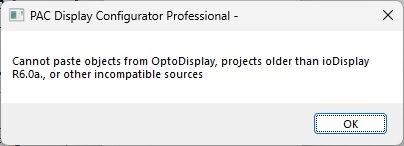

Here is the error I’m getting in PAC Display. Again, it seems to be something with the COMPUTER, not necessarily with the PAC Project project. That being said, let me know if you’d like me to send you our zip file.

I’ve reproduced the issue and implemented a fix that will be in R10.6a.
For the curious, Windows may occasionally report to PAC Display that the Windows clipboard is unavailable. If that happens when duplicating objects, PAC Display does not retry. It just shows you that misleading error message. Both of those items will be addressed in the next release.
