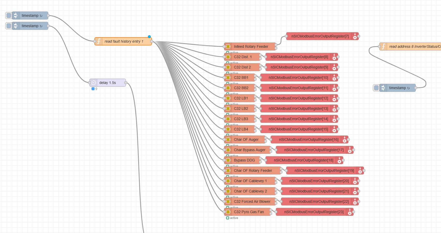

I’m looking for some advice on how to optimize the flex getter node. Currently, the implementation works quite well - until I cycle power on some of the devices. After cycling power, sometimes - not everytime, the inject seems to ‘stop’. Is there something that I can change to prevent this from happening. I was reading about this on another forum and someone wrote about packet collisions when cycling power, but I thought that the flex-getter was supposed to automatically queue the inject. I’m relattively new to this so I could be misunderstanding.

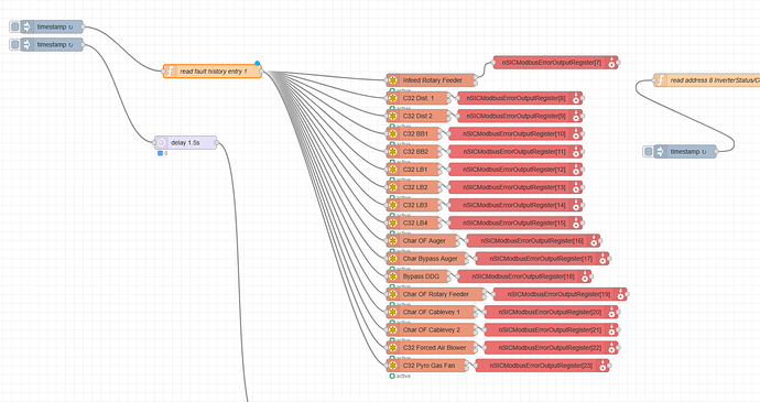

That’s a pretty terrifying screenshot depending on whats in the function block… Are you able to share the JavaScript?
msg.payload = (value: msg.payload, ‘fc’:3,‘unitid’:255,‘address’:500,‘quantity’:1)
return msg;
just reading the one register and then pushing it to PAC for error handling
So the function node fires off all those getter nodes at once.
I think that might be a big issue.

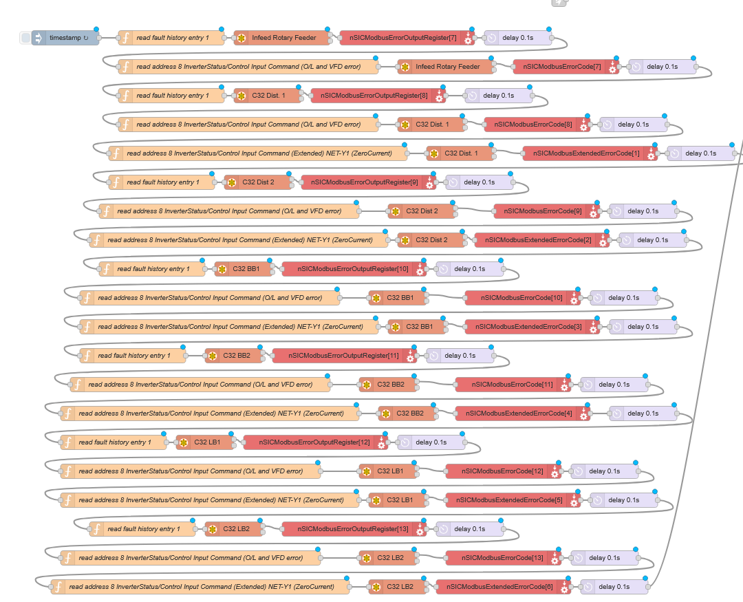

I modified my flow to a sequential style with some 0.1 s delays after each write to the PAC Controller. When I did this the flow was functional until a MODBUS device in the sequence was offline - then the inject stops at that device. Once back online, everything works ok again. Similarly, when the first device in the sequence is offline, the inject stops all together. This is the same problem I was having with my mass function inject.
Is there a way to automatically redeploy the flow to get the connection re-established? Redeploying the flow seems to be the only sure fire way to get the flow to start working again.

Glad you picked up the key point. Having more than 2-3 of anything parallel in Node-RED is usually not a good thing. Having as many as you had really was not getting the flow off to a good start.
Converting it to sequential style was the first step to debugging.

Here is the updated flow - so for example if the Infeed Rotary Feeder device goes off line I loose all the reads following. I don’t see anything about passing through on timeout in the flex-getter options.
I did not see anything either and yet it seems so obvious… hence I think its worth an ask on their GitHub.

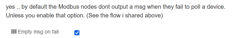

See this post:

Once again the forums to the rescue! Thanks @philip my flow now reads regardless of device state and isn’t going to ‘sleep’.
