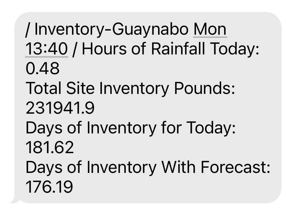

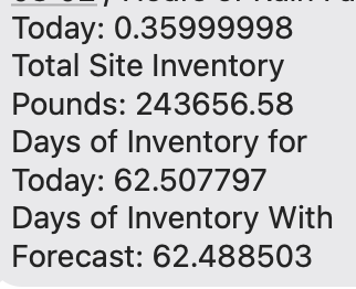

Ive been setting up some notification and would like to see if I can change the decimal points to 0 decimals.

To fix this sort of thing I always just end up using a Function node and a bit of JavaScript.
@torchard might have another way to reduce it…
Here is what I would use:
Three examples, you can clearly see the numbers of decimals you will end up with, 2, 1 and zero decimals places.
msg.today = msg.today.toFixed(2);
msg.totalSite = msg.totalSite.toFixed(1);
msg.pounds = msg.pounds.toFixed(0);
There are other options but this is the easiest way I’m aware of.
The only thing to be aware of is that toFixed() converts the number to a string. This is fine if you’re just putting the value into the text notification, but if you reference it somewhere else downstream that requires it to be a number, it might break.
