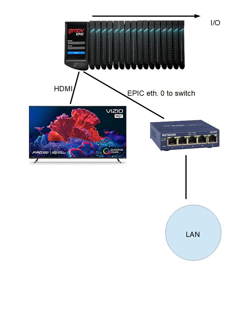

This happened and can’t make sense of it… Groov screen went into not reading any value and showing all as warning sign when EPIC lost network due to switch power failure.
A TV is used a local screen directly using EPIC HDMI connection and all i/o is directly connected to the EPIC. No remote brains, RIO’s or anything. Any clue about this? Loosing the network should not affect direct HDMI groov view or am I wrong? LAN is only used to monitor the system in some local computer.
