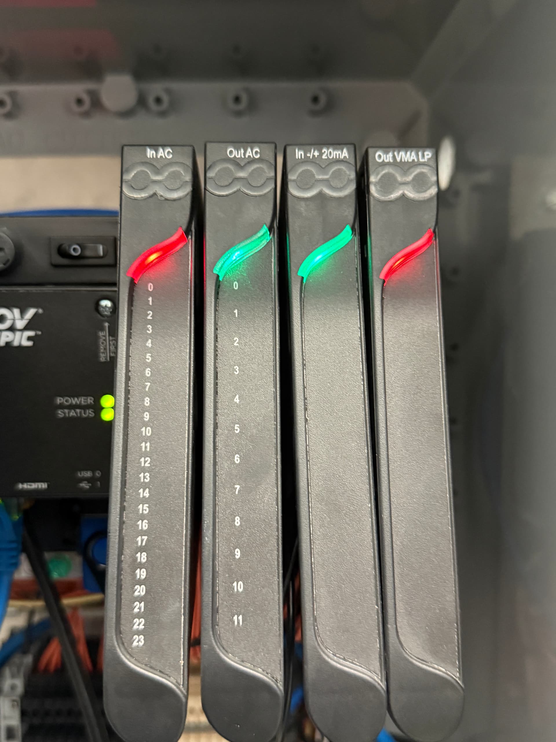

HI Guys,
recently came up with a problem with my Groov Epic, where the modules aren’t being recognized by the EPIC. I noticed the problem when some pumps werent working and thought it was the module. Shutdown the Epic, changed the module, and now its doesnt recognized the cards and when i connect with Pac Control, the Quality keeps coming in and out.
Any thoughts on what it could be? Back panel went bad?

Hi All,
was able to get everyting connected with a firmware update.
