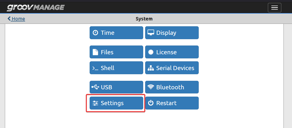

Yes. You can setup to go to groov View automatically.

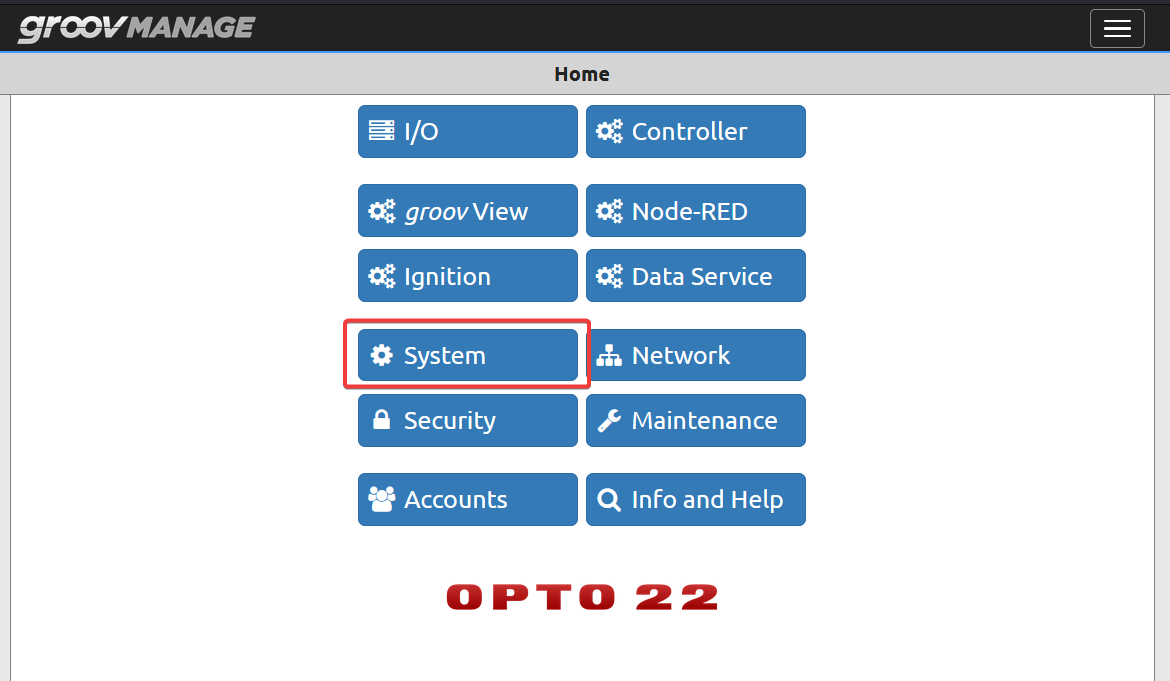

From groov Manage Home, click on System.

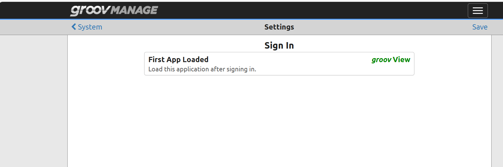

Then, click on Settings.

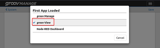

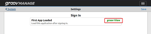

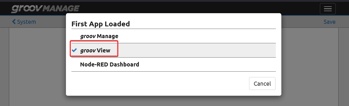

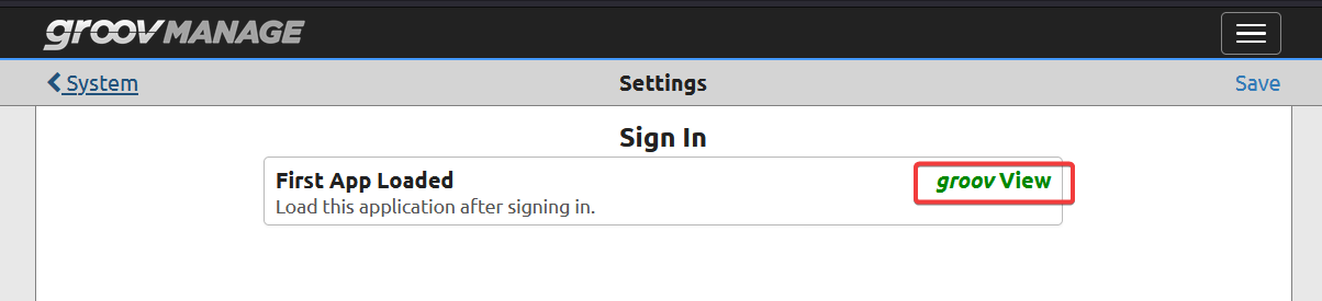

Then select the first app you want to load (run)
From the list, you can select groov View.
So, now still needs to login name and password to running groov view page?
Correct. Log in and groov View will be the first application launched as you asked.
