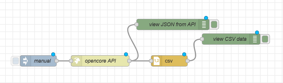

But, to your question, for tasks like this I find it best to break it down. Don’t try and do the whole flow at once.
Lets look at just first thing you need to do…
You don’t mention what is going to trigger the API, so lets just use an inject node that is set to manual.
It is CRITICAL that you do NOT add any more nodes until you have the API call returning JSON.
Don’t rush, don’t try and jump ahead.
Ok, so once that is up and running and we can see the JSON, whats the next step?
For that, we will need the CSV node…

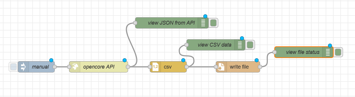

And the last part…
For that, we need the file node…
By building the flow up part by part, you should be able to ensure each section is working correct before adding the next.
