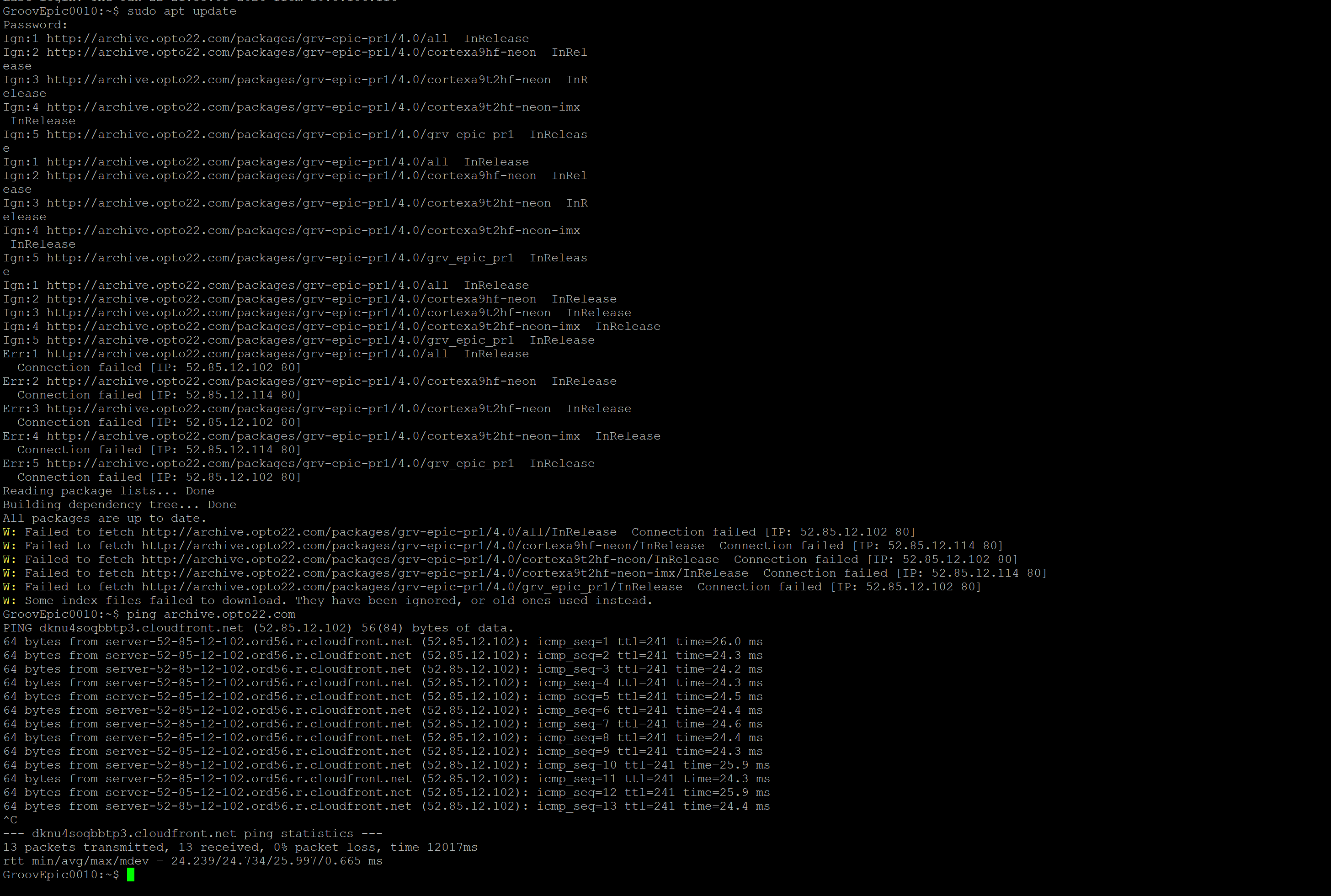

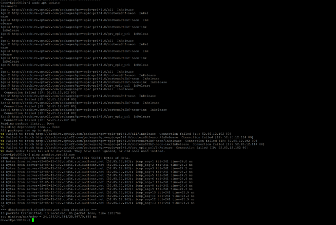

Looks like I can reach archive.opto22.com.
I did try sudo apt-cache search mariadb, db, maria a bunch of different search strings.
Attached is a screen. Groov Epic is connected to a network which might have restrictions I am unaware of.
Looking at this more:
If I had to guess, my device is being blocked by network from using http on port 80. I have no way to verify that right now, but I will arrange to have the device connected differently and report back.
That’s what I was worried about… Please do try a different network configuration and let us know if that gets you going.
