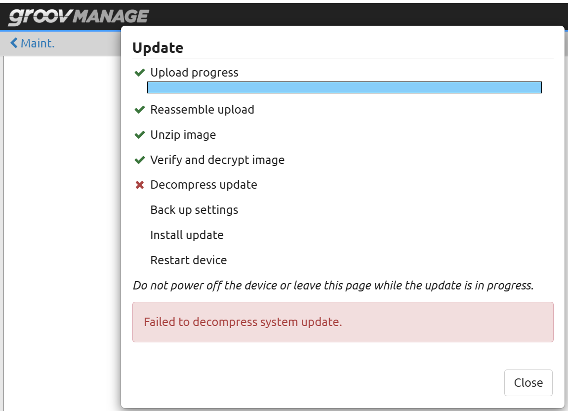

Working on the Groov PR1 side of this project,

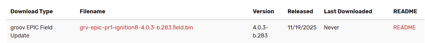

trying to update to
and I get

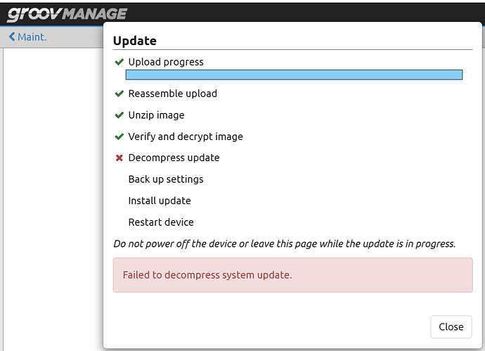

So is it safe to close the page? Gonna have a search now on this error message.
OK, I’m already on 8.1.21, bit annoying if you have to roll back to 7 every time you want to do an 8 upgrade…
The problem you are experiencing is related to the limited SSD space on a PR1, and the growing size of the firmware with Ignition 8. The firmware is now ~2.6GB with Ignition 8. On a PR1 there is just not enough SSD space to decompress the uploaded firmware file.
Here is a KB that describes that problem.
That is why there is a GRV-EPIC-PR2 with a larger SSD and more RAM.
There is a firmware without Ignition for the PR1 that you can install prior to the FW update with Ignition 8. That will speed up the updade process, because that firmware is much smaller and installs faster. You find it in your my.opto account. No need to install the firmware with Ignition 7 anymore.
