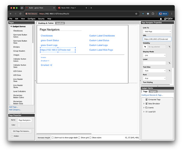

groov view’s Page Navigator Properties can be used to open a user’s web page via http, but can’t via https.
The EPIC’s Node-RED only support https, then how to build the end-point with EPIC’s Node-RED and http web page?
groov View’s Page Navigator gadget works fine with http or https; what trouble were you having?
Yes, the Page Navigator can open any http or https web page when the web page is installed in a stand along web server not in EPIC web server.
But our web pages are installed in EPIC-PR1’s web server, and as a parts of groov view utility. These RWD will be open by the gadget of the Page Navigator to access dB, PAC Control Variable via EPIC’ s Node-RED.
If the Page Navigator only support http then the RWD can’t work with EPIC’s Node-RED, that because the EPIC’s Node-RED only support https.
Did groov view has any other way to open a https web page which use EPIC as a web server?
I’m not sure what you’re referring to.

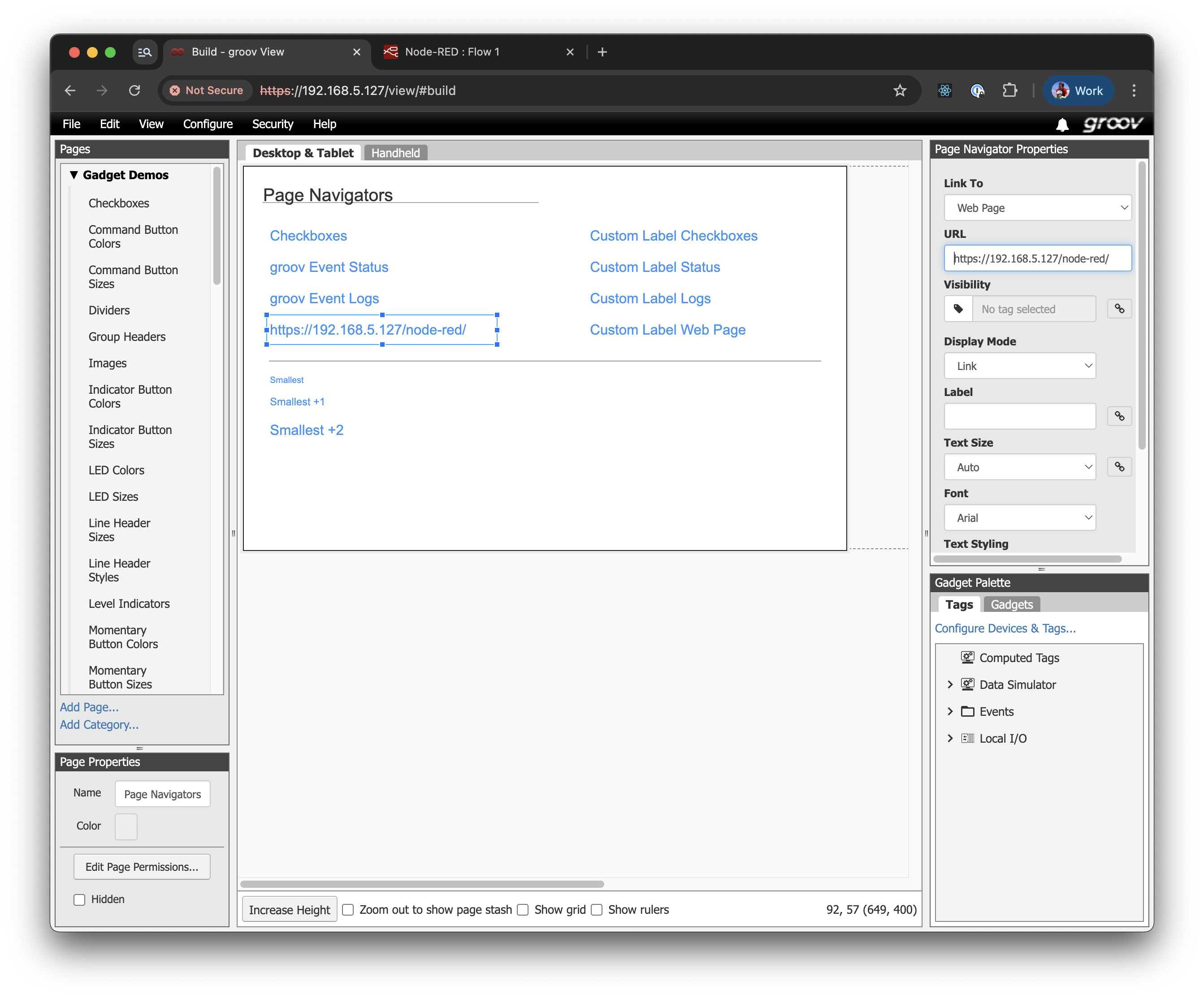

Here in this example screenshot I’ve configured a Page Navigator to open the local Node-RED instance on my GRV-EPIC. It works fine.
