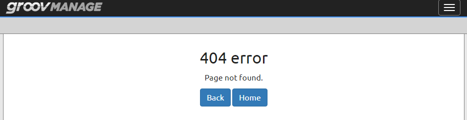

Also, any ideas about a 404 error when trying to access the LDAP user page to edit the user? (/manage/accounts/users/ldap:cn=…)

Regarding the 404. Any chance you remember how you got this to show? I’d love to be able to reproduce that here.
When LDAP settings are modified groov Manage invalidates existing users in the database. For example, suppose the User Search Base was originally too broad, and there was a user who wasn’t intended to be allowed to sign in. Then, the User Search Base is made more specific, and the LDAP settings are re-saved. Manage. invalidates all LDAP users as a precaution. There’s a message that pops up to confirm this change, “LDAP users that have been assigned permissions in ‘Local Permissions Mode’ will be lost due to the configuration change, and all LDAP users will be signed out.”
The issue you’re running into is likely due to trying to access a URL of a user that was in the system prior to modifying LDAP settings but was invalidated and is no longer present until next time they sign in.

This was simply by clicking on the user on the users page.
