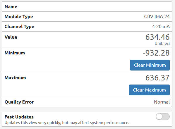

I’m trying to use the Swagger of our Opto Groov to set the value of an Analog channel but when I make the call, I get a 200 response but the value never changes.

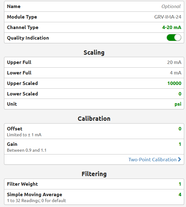

That’s quite an old version of firmware, so I just forget what options analog values had, but I wonder if you have a large deadband set and the value is not changing enough to move beyond the deadband limits, so that’s why it seems its not updating via the RESTful server, but you see the little changes in groov Manage?
I tried setting the value to a value close to the current value and one that was a ways away but still in the min/max range and neither changes the value.
I also updated the firmware of the Analog Module itself to the latest but that didn’t help. Currently trying to figure out who at our company has the activation key for the controller so I can get the latest firmware.
Input module values are set with wires.
