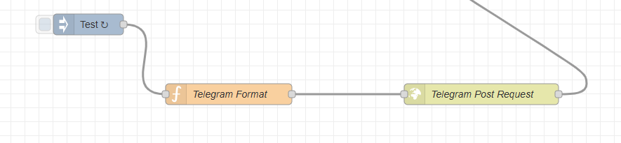

Since doing the Firmware 4 update, some HTTP request code that has been working for multiple years have stopped working - flow pictured below. It is very simple and the purpose is to send out messages through a http POST request.
Since doing the Firmware 4 update I have noticed I get this error in the debug window
(will have to upload this in comments as I can’t add more than one photo)
Remedies I have tried so far include:
  • Disable > Enable Node-RED
  • Restart Node-RED
  • Re-Import my whole flow
  • Restart my Groov Epic PR1
  • Ping test to 1.1.1.1 - 25ms response time as is normal for our network
  • Copied the code onto my laptop running the same version of Node-RED and ran it - this worked as expected
So I can confidently say that the service has internet access and has been restarted - even multiple times.
I’m kind of running out of ideas here, and I can’t think of what would be next. Has anyone else run into a similar issue? The fact that the code ran fine on another instance tells me that something in the update has obviously changed the way Node-RED on Opto Device talks to the net.
The firewall settings of the device have not changed, but maybe do I need to open a specific port to allow that http request to go out?
Update: I have also just updated the Web Server Certificate just in case- this hasn’t yielded any success.
(BOT Token has been crossed out for privacy)

EDT: uploading the Node-RED log produced in the groov manage window, which unfortunately doesn’t yield any other response
I have pinged api.telegram.org from the exec node on the Groov EPIC, it’s getting a response but with a huge latency spike
Pinging to www.google.com yields about 32ms
EDIT (again): I have just double checked, installed I have the same Node.js version however the Node-RED version I have installed on my laptop is 4.0.9 vs the 4.0.2 which was installed via Firmware 4. I can’t imagine there would be any major differences though, I will downgrade on my laptop to confirm
Update: Fortunately or Unfortunately the code is still working. I can confirm I am running the exact same version of Node.Js and Node-RED as the Groov EPIC.
Its interesting that debug says https://api where the Node-RED log says http request. I would think it all should be https…
I don’t want to read toooooo much into that as it might just be a generic error vs a real one.

I have just spent a bit of time trying to implement thatm and unfortunately I have just had the exact same result. Not working on Groov EPIC, returning an ‘aggregate error’ message. Copy and pasted exact same code to my laptop, works perfectly (although I think I’ve now been convinced to swap to the telegram node rather than using the HTTP Request node).
