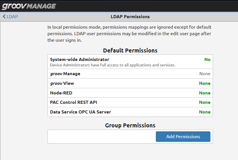

If I set up LDAP, I read that all internal user accounts are disabled. Does that also disable the initial internal Device Administrator account? Can LDAP be set up to apply to Access only with Permissions, like Node-RED editor, defined internally on the EPIC system? One of our EPIC systems has Ignition 8 Vision which seems to support this concept.
Enabling LDAP does not disable any created internal user accounts. You can use them in tandem. The LDAP accounts are configured with a set of default permissions, that you can modify
