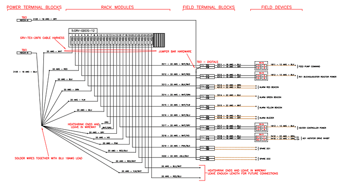

I am looking for jumpers that work with the EPIC cards. Does anyone have any solutions or suggestions?
Has anyone found a jumper that works for Groov I/O cards?
We made our own initially and then after requests they made harnesses which I recommend unless you only use a few channels
Sounds good but I’ve only seen jumpers for the SNAP PAC system, I would really appreciate a link if you’ve got it.
