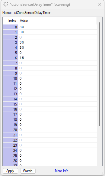

Its a float table with timer second values. I did verify the table it didnt have any large number.

The table has 3 variables those are loop variables to identify the index. The table has the timer values used those loop variables I find the index of which value to set. The table is persistent, the variable are not. All the other variables, table did hold the values its just this one timer which went into infinite. This line of code can never excute with improper values, as there are tons of error checks before this. Those variables are used only in this chart no ever else in the program.

The values are entered from groov view. Not the running timer, the preset values are stored as persistent.
From groov view with all the error checks. User can’t enter more than 500 seconds with max and min clamping in strategy also. Yes added the timer > setpoint it will reset the timer. But the issue is with the preset value of 60 seconds how can the value go to infinite or large value.
