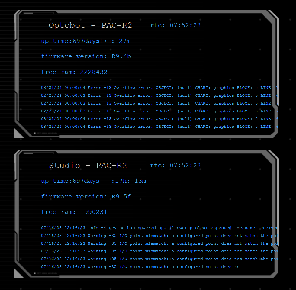

I take it you mean something like this?
Here is my current groov View screen.
Firmware is at MMP: 0xFFFF F030 001C
I could go on, but open PAC Manager and grab the MMP addresses of what you are looking to put on the HMI and you are about done.
