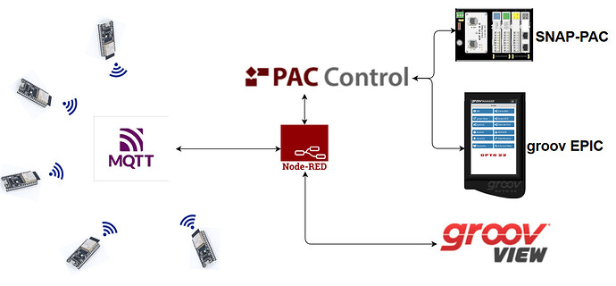

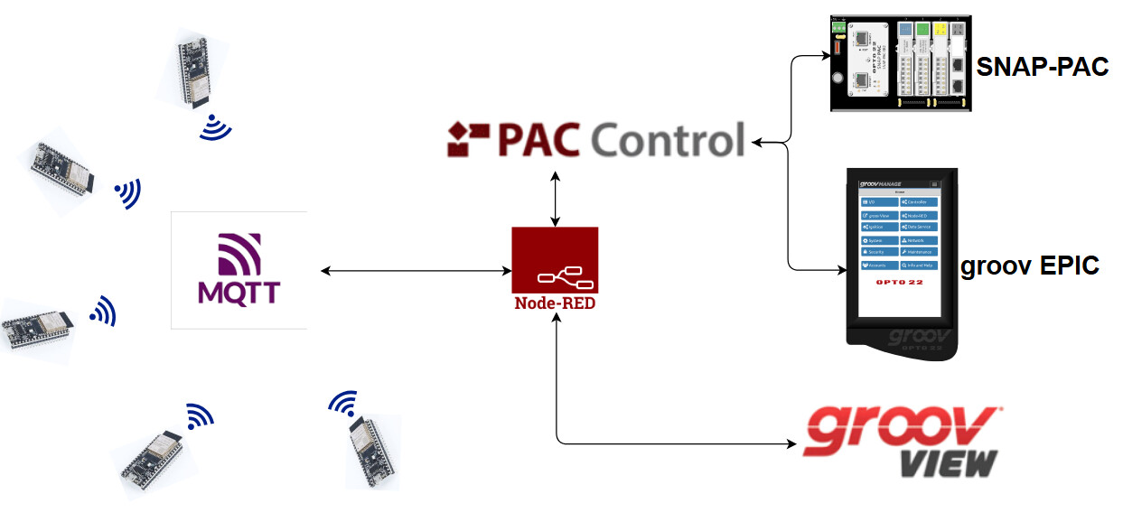

I agree with @torchard that Node-RED may be the simplest set up.
I would also add that using Node-RED comes with other advantages like database connections and, if you don’t need the sensor value in your control logic, ability to send sensor data directly to the groovVIEW (HMI/UI).
If go with MQTT it will give you scalability and topic namespaces could provide context for wireless sensors dynamically.
