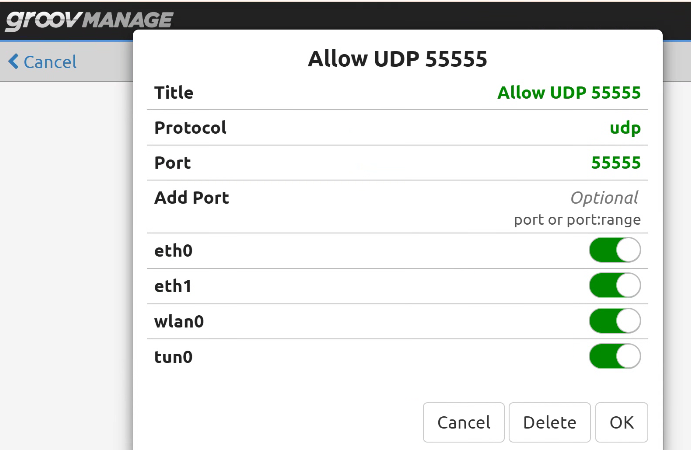

  1. I created a firewall rule in groov Manage to allow UDP 55555

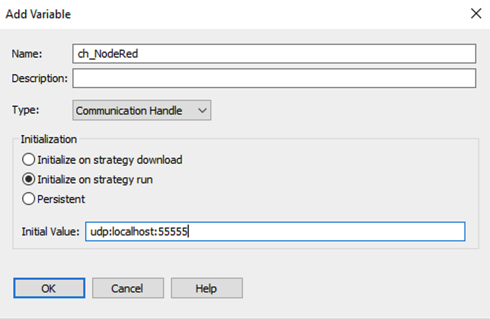

  2. I created a Communication Handle called ch_NodeRED in my PAC Control program, but I am pretty sure I am missing content here.

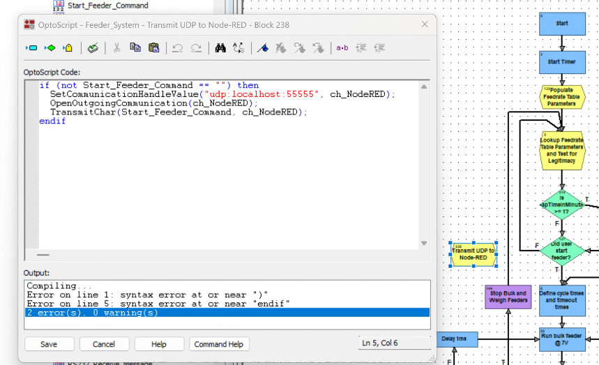

  1. I created this OptoScript box, but did not insert it into the flow diagram. I my case, all I am trying to do is listen for the Integer32 variable called Start_Feeder_Command (which has a 1 or 0) via UDP 55555. You can also see that the test compile revealed several errors. Do I have to insert this OptoScript block into my flow (just after the green diamond that says “Is Start_Feeder_Command equal to 1?”)? Any ideas how to resolve the syntax errors below?

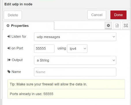

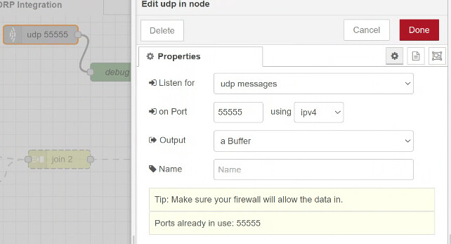

  1. In Node-RED, I set up this UDP In node as shown below, but I see a warning “Ports already in use: 55555” which maybe is referring to PAC Control?
Thanks in advance for any pointers.

  1. Your firewall rule looks pretty much like mine. I only selected eth0 and tun0, but that’s the only difference.
  2. I don’t think you’re missing anything in the Communication Handle definition. Mine is defined the same way (inside a subroutine even).
  3. I’m guessing the issue here is that you’re comparing an int32 variable to an empty string. Try converting your int32 to a string first and use the string. Also, I’m using TransmitString, not TransmitChar. Also make sure there were no weird copy/paste issues with curly quotes.
  4. I see the same message about the port already being in use, so that doesn’t concern me. I did set the output to “a String”.

I don’t think you need firewall rules when communicating on localhost.

Use TransmitString like varland said - TransmitChar only adds the character to the outgoing buffer, it doesn’t actually send it.

Just to be clear, does my OptoScript block need to be connected with arrows in my flow? Or can it just sit off to the side as it presently is. If it’s in my flow, then I’ll put it just after Start_Feeder_Command changes.
My revised block is:
if (not Start_Feeder_Command == “”) then
SetCommunicationHandleValue(“udp:localhost:55555”, ch_NodeRED);
OpenOutgoingCommunication(ch_NodeRED);
TransmitString(Start_Feeder_Command, ch_NodeRED);
endif
@philip You wrote:
Can you clarify what you mean? Should I change my OptoScript above?
Yes or it will never run.
Put the “udp:localhost:55555” in the variable definition and you can delete that line. It probably won’t matter if you leave it though.

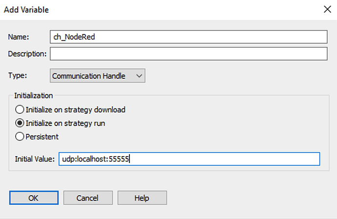

@grant1:
Define your communication handle like this:
Doing this means you can eliminate the SetCommunicationHandleValue command from your OptoScript code. Your code will be marginally more efficient, and you get the benefit that if you reuse that communication handle in other places, you have one central definition. Mine is initialized in the code because it’s inside a subroutine and subroutine instance variables aren’t persistent, but there’s no reason not to do it like @philip said.

Everything works now. To recap…
  • Eliminated the UDP firewall rule (not required since I’m using localhost)
  • Put udp:localhost:55555 in the Initial Value box of the communication handle ch_NodeRED
  • Created string variable called Start_Feeder_Command_String

  • Used UDP in node configured like this:
