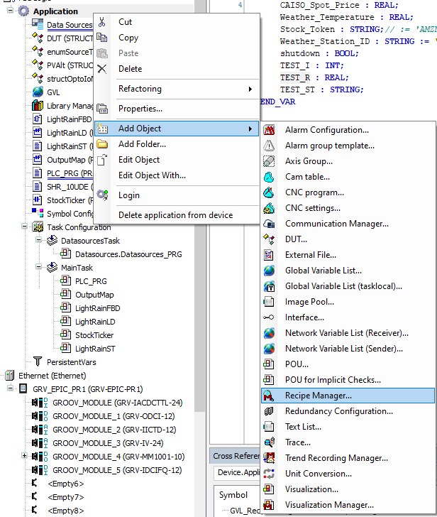

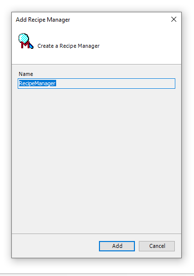

Create a new Recipe Manager, Right click on Application→Add Object→Recipe Manager
Add the Recipe Manager to your application

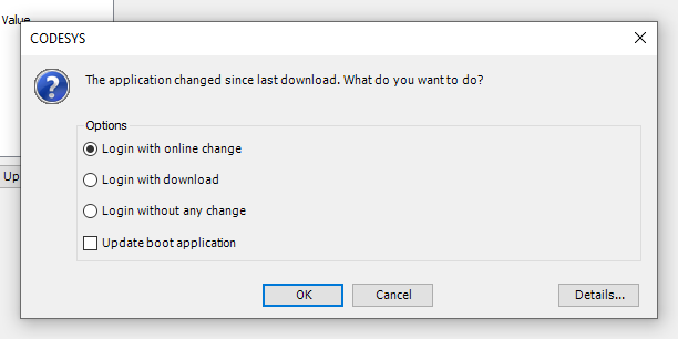

Login to your EPIC and download/online change to add the Recipe Manager
3-Login

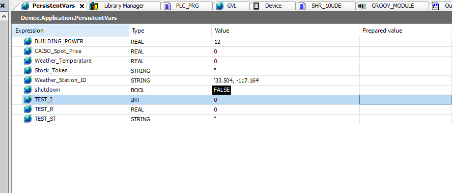

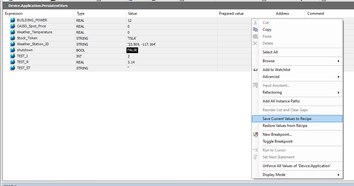

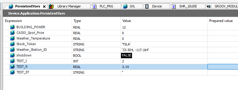

Open your Persistent Variables list Select all variables you want to back up and right click→“Save Current Values to Recipe”
Uploading: 6-System Auto Generates Recipe Open the Recipe.png…

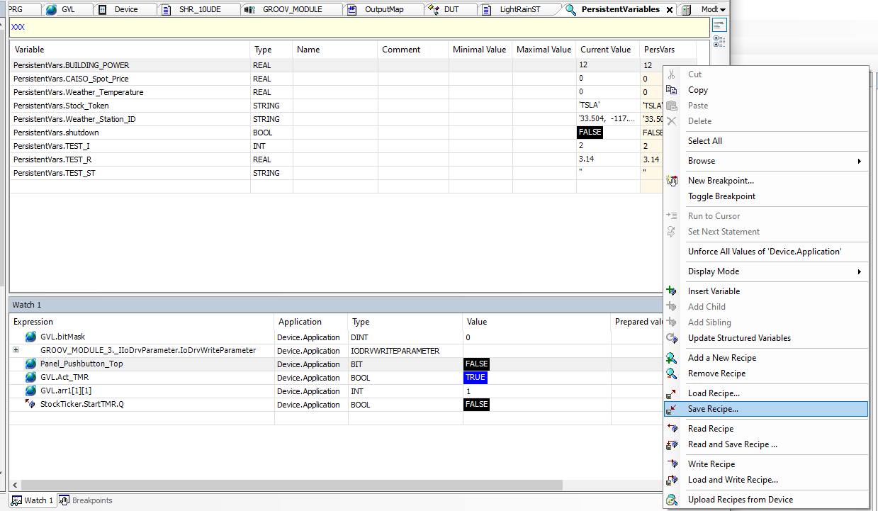

Codesys will add a new table to your Recipe Manager called “PersistentVariables”
Open the new “PersistentVariables” Table and right click→ “Save Recipe”

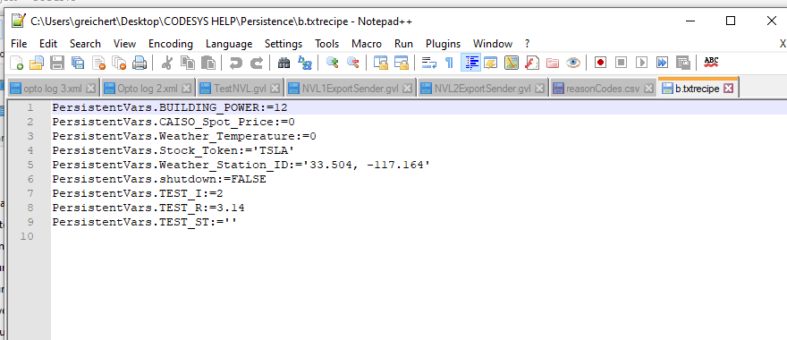

After saving you can open the *.txtrecipe file and verify the values were stored.

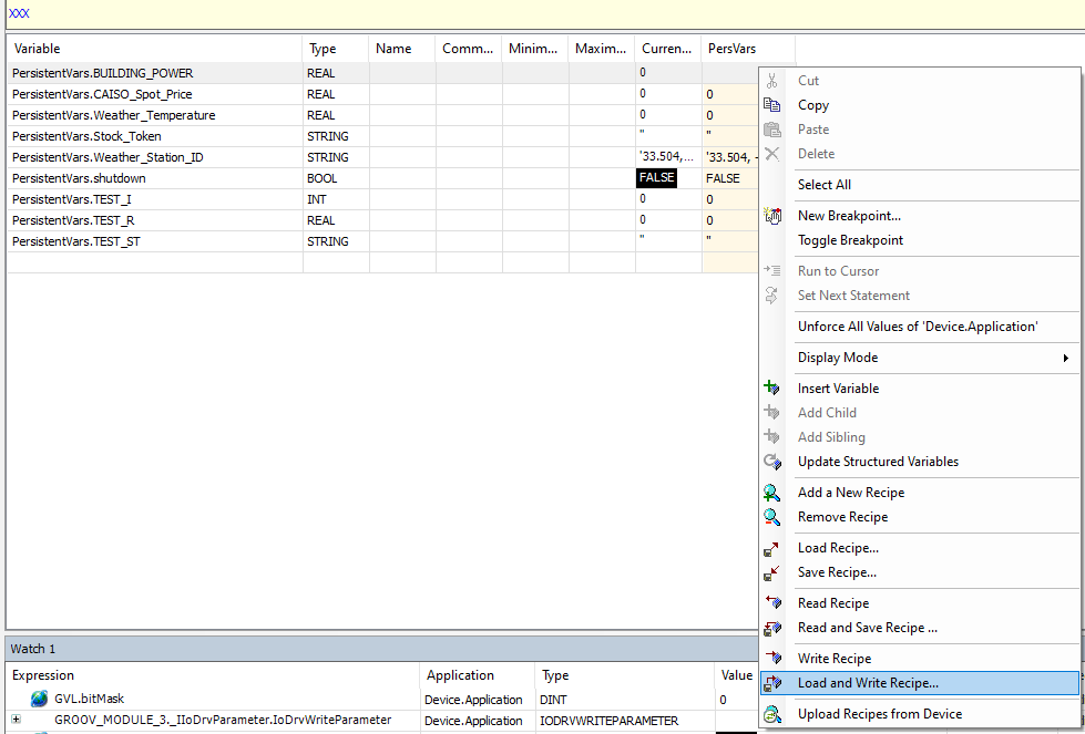

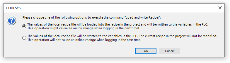

Open the “PersistentVariables” Recipe and right click→”Load and Write Recipe”
Select the appropriate write parameter and load the *.txtrecipe file.
Verify the data was written to the Persistent Variables List

For clarification on Saving/Loading the Recipe. Please make sure you have the PersVars column selected when you right click to save/load.
