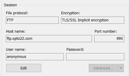

If you have an ftp client you can get all the previous versions from the ftp site. The site uses TLS with a self-signed certificate at port 990, so you need to use a client that will support that - I use WinSCP. User name anonymous with blank password.
PAC 10.x Firmware is at the following path
/Public_Folders_(Unsecured)/Archives_(Software_and_Firmware)/Firmware_Archives/SNAP-PAC_Firmware_Archives/Released/10.x

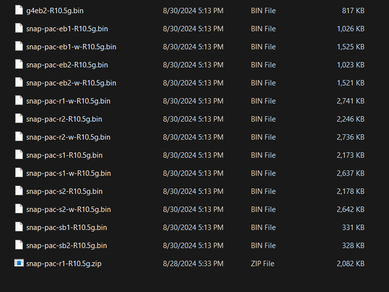

Problem - there’s another page, with the perfectly cromulent title “Firmware for all SNAP PAC products.” Seeing a page with that title, there is absolutely no reason a user would suspect that they are in the wrong place.
But if you download the .zip file from THAT page, it has only this file:
snap-pac-r1-w-R10.g5.bin
There’s that sneaky little “w”, but that’s the only indication that that ISN’T the correct download for a SNAP PAC R1, especially given that the page title is, again, “Firmware for all SNAP PAC products.”
I would suggest either adding the R1 version to the larger zip file, or making clear on the latter page that it ISN’T a comprehensive zip file.

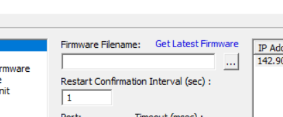

I just confirmed that the 10.5 version from the page you linked will indeed install on our PAC. In the process, I realized that there is a link inside PAC Manager Itself that points at the page I linked in my post, which may explain why we were looking there. :slight_smile:
For those finding this thread in a future time…
Clearly, we did not make things super clear, but the file is in the ‘Firmware for all SNAP PAC products’ download… (And in the file location linked from PAC Manager)
The tripping point is that its the last one in the list there… its a zip file, not a .bin file.
Waaaay to easy to skip over.
When you unzip that r1 file…
You find the same files as from the page I linked to.
So, yeah, its all there, it all works, its just not super clear.
I will work with the doc’s folk… My vote is to put the three files as .txt and the two .bins in the ‘all firmware’ file.
